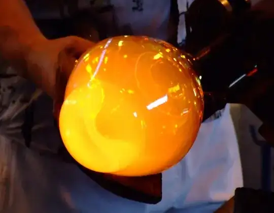

Though, this explanation does not work for glass. If you heat glass, it emits visible (glows), meaning either of two things:
  1. it absorbs visible and re-emits visible
  2. it absorbs all wavelength and re-emits visible (in cascades or for other reasons changes the re-emitted photons' wavelength relative to the absorbed ones)
Question:
  1. Why does hot (molten) glass glow, while diamond does not?
Clear glass does not glow all that much in the visible. The illustration seems to show quite thick glass, and it is impossible to see from the image whether it is clear when cooled down. The temperature would be quite high (1000 °C or more), an opaque object at the same temperature would radiate more.
Edit: an image from https://youtu.be/FXXwCNSiAFY Hot glass, Noomoon Pictures
