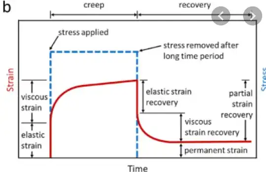

When studying the viscoelastic response of materials, there is a test termed a creep/recovery test. In this test a constant force (or stress) is applied and the strain (or response) of the material is monitored. Usually there is a large initial strain followed by 'creeping' of the material. This is like sitting down on a sofa. There is first a large deformation of the cushion and then you will slowly depress it (sink further into the couch) even further over time. Again, if you remain in the linear viscoelastic region of the material, when the stress is removed (you get up from the sofa), the material will 'recover' its form. If you did not stay in the linear viscoelastic region, there will be a permanent deformation in the material.
This is what a creep/recovery test (with permanent strain induced) looks like:
Reference: https://doi.org/10.1016/j.memsci.2019.04.068
Reference: R. D. Gustafson, A. L. McGaughey, W. Ding, S. C. McVety and A. E. Childress, "Morphological changes and creep recovery behavior of expanded polytetrafluoroethylene (ePTFE) membranes used for membrane distillation", J. Membr. Sci 584 (2019) 236–245.
So with paper, I would say it is easy to enter the plastic deformation region by rolling it, though I think it also depends upon how tightly you roll it. You are essentially performing a creep/recovery test. If you roll it tightly and hold for a long period of time, you will get less recovery, than if you slightly rolled it and let go immediately. And the structure of paper on the microscopic level means it is easy to distort in this manner. (Much harder to do a creep/recovery test with your hands and enter the plastic distortion region by pulling along the planar direction of the paper!)
