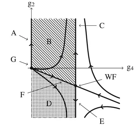

It is well-known, that in $\phi^4$ theory in 3d there is interaction fixed point:
$$ S_{\Lambda} = \int d^dx \left[\frac{1}{2}(\partial_i \phi)^2 + \frac{1}{2} \mu_0^2 \phi^2 + \Lambda^{d-4} \tilde{g}_0 \phi^4 \right] $$ From equations of Wilsonian Renormalization group we immediatly obtain WF point, using $4-\epsilon$ expansion: $$ \begin{cases} \frac{d\mu^2}{ds} = 2\mu^2 + \frac{3}{2\pi^2} \frac{\Lambda^4}{\Lambda^2 + \mu^2} \tilde{g}\\ \frac{d\tilde{g}}{ds} = \epsilon \tilde{g} - \frac{9}{2\pi^2} \frac{\Lambda^4}{(\Lambda^2+ \mu^2)^2}\tilde{g}^2 \end{cases} \;\;\; \Rightarrow \;\;\; \begin{cases} \tilde{\mu}^2_{\star} = - \frac{1}{6} \frac{\Lambda^4}{\Lambda^2 + \mu_\star^2} \epsilon \approx -\frac{1}{6} \Lambda^2 \epsilon,\\ \tilde{g}_{\star} = \frac{2\pi^2}{9}\epsilon \end{cases} $$
But this analysis is possible only in vicinity of Gaussian fixed point.
Is the WF point unique? Or in strong coupling limit there are some other points?
