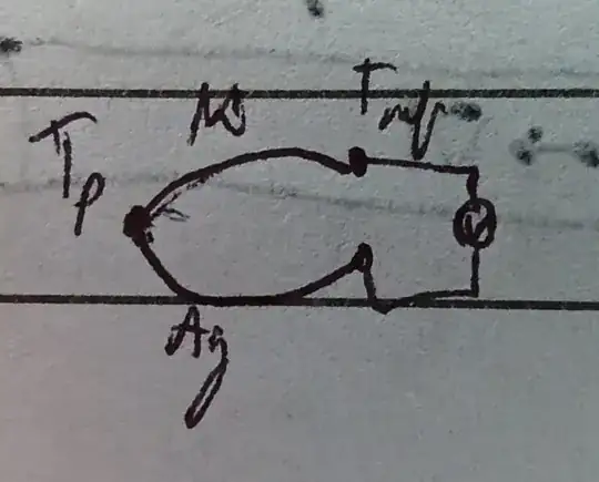

Draw a "circuit" of the thermocouple attached to a voltmeter, like in the following picture. enter image description here
I picked $T_p$ as the probed temperature. $T_\text{ref}$ is a reference temperature, Ni stands for nickel and Ag for silver. In this particular case, the voltage read by the voltmeter is $V=S_\text{Ag}\Delta T - S_\text{Ni}\Delta T$, as long as the voltmeter's lead are of a single material (regardless of which material it is).
So a quick explanation would be that a thermocouple is a union of two materials made at a point where one seeks to probe its temperature. Thanks to the Seebeck effect, which states that a temperature difference across a material induces a voltage proportional to this temperature difference, one can arrange a simple setup where reading the voltage of the couple leads back to $T_p$ which is the goal.
The reason this works is because $T_\text{ref}$ is assumed to be known as well as the Seebeck coefficients of the two materials (in a given temperature range), hence the knowledge of $V$ yields the knowledge of $T_p$.
Responding to your comment, I will give a try that involves some physics. From Onsager theory, we have the generalized Ohm's law $\vec J_e = - \sigma \nabla \overline \mu - \sigma S \nabla T$ which tells us, amongst other things, that an electrical current can be due to both an applied voltage or a temperature difference across a given length. In the case of a thermocouple, there is no current and so $\vec J_e = \vec 0$ from which one derives the relation $d\overline \mu = - SdT$.
At any of the junctions of the materials making up the thermocouple, the conditions are isothermal and there is no current. This means that the electrochemical potential $\overline \mu$ is spatially continuous at the junctions. From this information, one gets $V = \int _{T_\text{ref}}^T (S_\text{Ag} - S_\text{Ni}) dT$ (voltage displayed by the voltmeter) which is essentially the formula I wrote above.
