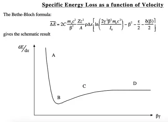

I am told that this version of the Bethe formula shows that, as the particle energy grows, specific losses for ionization decrease at first very rapidly (inversely proportional to energy), but do this more and more slowly as the particle velocity comes closer and closer to the light velocity. This fact is not immediately clear to me from the equation, and I was not provided with any graphs to illustrate the phenomenon. In researching this further, I found this document, which provides the following illustration:
As can be seen from the graph, $\beta \gamma$ is plotted on the $x$-axis, so I'm presuming that this is the specific energy? But, if so, then this graph is not describing the aforementioned phenomenon: At first, particle energy decreases very rapidly, and $\beta \gamma$ increases very slowly; and then, at some sudden minimum, particle energy starts to increase very slowly, and $\beta \gamma$ increases very rapidly. So this still leaves me confused.
I would greatly appreciate it if people would please take the time to help me understand this by carefully explaining the equation $\dfrac{dE}{dx}$ and its behaviour as described in the aforementioned description ("as the particle energy grows, specific losses for ionization decrease at first very rapidly ..."), and how this relates to the provided graph.
$\frac{dE}{dx}$ here is the rate of energy loss versus distance traversed by the incident charged particle. The horizontal axis is $\gamma \beta=\frac{v}{\sqrt{c^2-v^2}}$, which makes the graph more convenient since the behavior changes as the particle becomes relativistic. The first part of the curve is saying that slow particles lose energy rapidly. The $1/v^2$ dependence can be derived from the nonrelativistic classical Rutherford cross section. Once the particles become relativistic, the $1/v^2$ dependence is cut off, and the appropriate relativistic calculation gives the logarithmic dependece for large $\beta \gamma$.
J.D. Jackson's Classical Electrodynamics in chapter 13, shows how to derive these equations in section 13.1-13.3 and provides a figure very similar to yours. I suggest reading those 10 or so pages to get more details.
