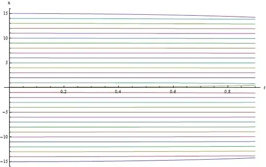

Lumo's answer is good. I would accept it. Only because I'm bored and it's easy here is a numerical simulation of 31 planets (a poor man's infinity), placed initially at rest at the integers, except the centre body is displaced upward by 0.1:
Note that, of course, the outer bodies fall toward the middle since there are only finitely many planets here. Planets 0 and 1 fall towards each other much faster than any of the other bodies (apart from the outer two), and the distance between 0 and -1 is increasing. This agrees with Lumo's prediction. The other bodies are nearly stationary, which gives confidence that the boundary conditions aren't numerically important for understanding what is happening in the middle. Shortly after this plot ends bodies start colliding and this simple simulation breaks down. So in units where everything is 1 it takes about 1 unit of time for bad things to happen. :)
