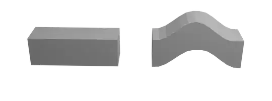

Similarly, in 3 dimensions, we can only bend a 3-dimensional Cube over 3 dimensions:

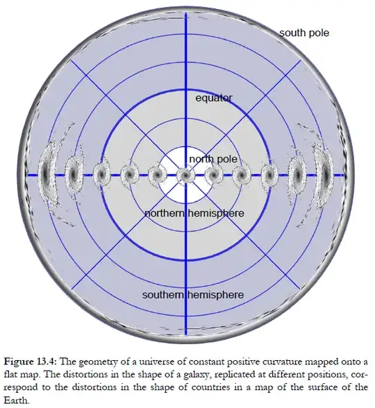

Intrinsic curvature is not difficult to understand (at least conceptually), and it needs no concept of bending into higher dimensions. It can be understood in the same way that you see the curvature of the Earth on a flat map, through local scaling distortions of the map. Here is a map of a universe with positive curvature. The central galaxy is not distorted, but greater distortion is seen further from the centre (diagrams from Structures of the Sky more explanation, without maths is given in The Large and the Small)

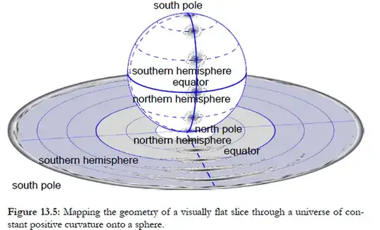

You can “undo” the scaling distortions on this map by mapping it onto a sphere, showing that the map would be the same whichever galaxy you choose for the centre.

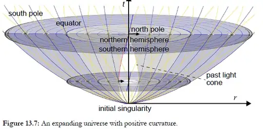

Note that the sphere has no physical meaning. It is just a way of drawing a map. We can also draw maps of expanding spacetime, like this. The galaxies do not get bigger, but the distances between them gets bigger.
Other maps can be used. This one is exactly equivalent, but instead of the universe appearing to expand, galaxies appear to get smaller.

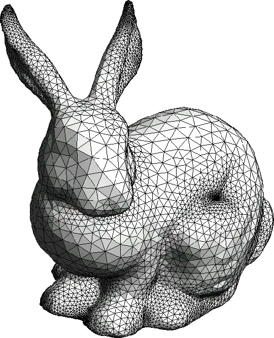

The bunny is composed from bunch of points and lines connecting neighboring points, which creates triangles. Each triangle tells you what are the distances and angles between neighboring points. In fact, the knowledge of length of every line in the picture is sufficient to answer every question about geometry some 2D physicist living on this bunny could hope to ask (of course in reality there should be infinite amount of infinitely small triangles). And our physicist need not concern himself with 3rd dimension, he only needs to know distances in his 2D space.

In your first example, when you are bending sheet of paper, ask yourself what changes does the bend assert on measurements restricted to the sheet itself? If you make it into triangles, the angles remain the same and the distances too. Thus the bend you showed does not actually curve the geometry of the paper at all. You just created extrinsic curvature, but this curvature is inaccessible from the paper. Someone living on the paper thinks it is still as flat as ever.
You could then stretch the paper and this would certainly change the drawn triangles. But this wouldn't still curve the geometry. Stretched paper, is as flat as non stretched one. Triangles changed, but they still obey Euclidean geometry. You can simply view your deformation as simple redrawing of triangles (let us ignore global properties for a while and focus only at small neigborhood of some point of the paper) When you draw a circle, its circumference will be $2\pi r$, where $r$ is radius.

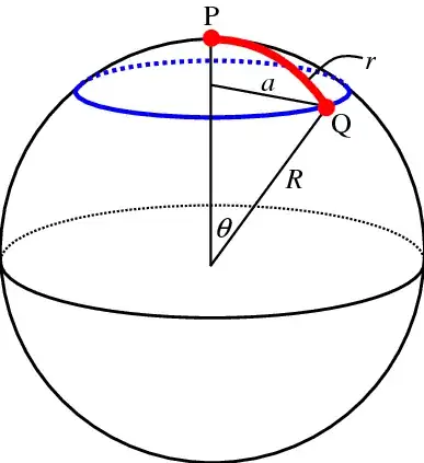

Only once you deform the paper in such a way as to make high school geometry formulas fail will you create intrinsic curvature. Take for example a sphere: enter image description here
Suddenly, the circumference of the blue circle is not $2\pi r$. It is $2 \pi a$, but the physicist living on the sphere cannot measure this $a$. He thinks $r$ is the radius and thus he will find out that something fishy is going on. The geometry is weird. The space thus must be curved.
