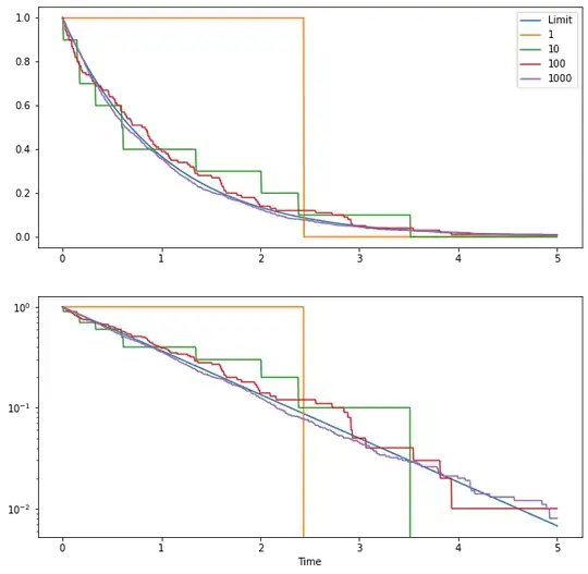

As an illustration, we can simulate the radioactive decay, using various starting number of atoms. We get something like this:
simulated decay
The two plots show proportion of remaining atoms as a function of time. The bottom panel uses a logarithmic scale to better see what is happening. Each curve shows a simulation with a given starting population (from 1 to 1000 atoms). As you can see, as you increase the number of atoms the curves converge rapidly to the limit curve (in blue). As the numbers of atoms in a lot of problems in much larger than 1000, it makes sense to use the limit curve to model the atom population.
