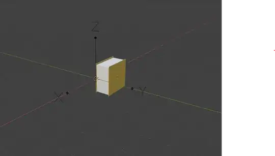

There are two identical parallel plates of length $L$ and breadth $B$ on the XZ plane . One plate passes through $Y = 0$ and the other passes through $Y = d$. Between them is a dielectric medium whose Dielectric constant changes as $\kappa = \kappa_0(3 + \frac{y}{L})$. Calculate the Capacity of the parallel plates.
two parallel plates in the XZ plane with a dielectric material between them
