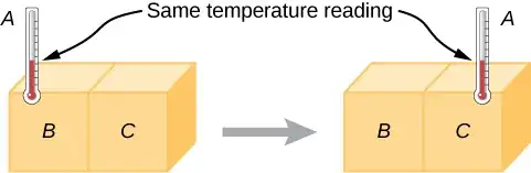

thermalequillibrium
Figure 1.2.1: If thermometer A is in thermal equilibrium with object B, and B is in thermal equilibrium with C, then A is in thermal equilibrium with C. Therefore, the reading on A stays the same when A is moved over to make contact with C.
