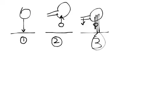

I was playing table tennis the other day when I my ball fell off the table. I placed my paddle above it in order to slow it down, and then I brought the paddle to the ground so that the ball would come to a stop. A diagram of what I did is below: picture
Why did the velocity of the ping pong ball increase so much at the end? I did not apply much force while lowering the paddle, so I didn't think it was because I applied a greater force to the ball.

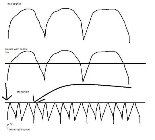

Also, I believe there is a third phenomenon: when a ball bounces, its speed decreases as it rises. By cutting off the high part of its bounces (which is when it is moving the slowest), you are restricting it just to the fast part of its bouncing, increasing the average speed of the ball.

When your ball is allowed to bounce freely, it reaches a speed of zero at the top of its arc. At that point, all of its kinetic energy has been converted to gravitational potential energy. The opposite is true at the ground, where all its gravitational energy has been converted into kinetic energy. For a perfectly elastic collision, what you are doing when you lower the paddle is truncating the bouncing ball's arc (with a corresponding increase in frequency). In an ideal case, where you add no extra energy to the ball, the ball's speed at each height does not increase, but the ball's average speed increases drastically, because the ball is moving so much faster in the free arc when it's closer to the ground.
