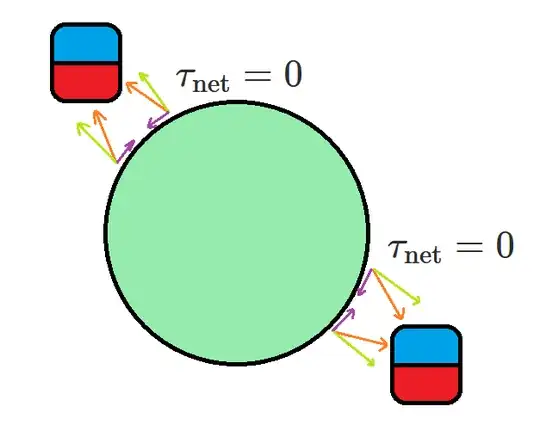

I am not a physicist, but I know the first law of thermodynamic (conversation of energy), and I have connected this with an idea that came to my mind some time ago to create perpetual motion machine which impossible according to the first law of thermodynamic.
This spinning wheel is made of ferromagnetic material ,So a force will be applied on the wheel causing a torque ,If we put this in place with no air ,and these are permanent magnets so they are going to apply a force permanently,and the atoms in the ferromagnetic material will not be aligned because the permanent are in opposite directions so how would this wheel stop acceleration ?

You are incorrect that there is a torque on the wheel. While the field from the permanent magnet may pull a bit on some sections of the wheel, the total pull averages to exactly zero.
Yes, some of the bits of the wheel want to move clockwise to be closer to the magnet, but some other bits of the wheel want to move counterclockwise to be closer. We don't get to only consider the bits directly in front of the pole of the magnet. The entire magnetic field must be considered. When summed (assuming the wheel is homogenous), the torque will be found to be zero.

Though user BowlOfRed has provided an excellent answer clarifying the flaw in your argument, here's my take at trying to provide a visual reasoning as to why this idea might not work.
First of all, the direction of the forces in your illustration which comprise the couple aren't in the correct direction. Here I'm assuming your "very good" disk has no memory of magnetization whatsoever and it's a simple piece of ferromagnetic material. The best you could do was to invert the black arrows in your diagram. Still, you'd be missing something and it'd fetch you $0$ net torque as the user mentions ;)
Here, if we see carefully, we can see the two pairs of torques (marked in violet) which are mutually cancelling each other.
Hence, the idea might not work very well.
For analysis in greater detail, I think we must also consider the interactions due to the magnets but that will complicate the matter further and moreover isn't of much use here.
