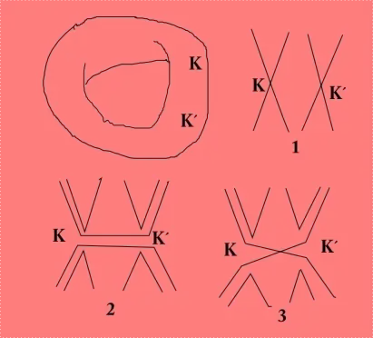

If you glue the 2D Brillouin zone properly you will get a torus. And as I understood there are two cases shown in figure below that create a gap in the 'bulk' graphene. Case 1 show two valleys without gap. Case 2 is the normal insulator case. Case 3 is the TI case. enter image description here
For the energy space I mean the band structure (I don't know its relation with Hilbert space.) Not sure about how to glue it and if a Klein bottle will be formed.

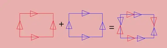

update3: Just got some ways of mapping 2 tori to a Klein bottle. (shown below, sorry for the bad drawing) enter image description here The cover of the book shows how to map a torus to a sphere.
Is this the way to understand mapping from momentum space to band structure (or topology of the system)?

First of all one must be careful to distinguish band structure of the bulk from band structure of a semi-infinite strip (with edges). In your second figure, 1 og 2 are bulk band structures while 3 is band structure of a semi-infinite strip. I think you are mixing these.
  • Bulk picture: Both momentum $k_x$ and $k_y$ are good quantum numbers. Assume you start with a trivial insulator (gap in the band structure, number 2 in your picure) and you continuously change the parameters of your system. As long as the bulk gap i open you have a trivial insulator. Suddenly the bulk gap closes, at one value of your parameters (critical point), and quickly opens up again, now you are in the topological phase BUT the bulk band structure still looks like figure 2 above. How to see the difference in these two phases? One way is looking for edge states.
  • Edge picture: Make the system finite along $y$-direction, so now only $k_x$ is a good quantum number. Now you have alot of bands, depending on how many lattice sites you put along $y$. When you are in the trivial phase the system is still gapped and boring. While you change the system parameters and hit the critical point, the gap of all bands close and then most (but not all) bands open up again (picture 3 above). When one looks at the eigenvectors, one will see that the bands with a gap correspond to bulk states while the band(s) with no gap (with a Dirac point) correspond to states localized along the edge. Furthermore these edge states are robust.
