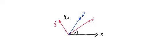

The components of a vector $\vec{p}$ are $x$ and $y$
$$\vec{p}=\begin{bmatrix} x \\ y \\ \end{bmatrix}$$
where $x,y\in\Re$
thus the magnitude of $\vec{p}$ is $$|\vec{p}|=\sqrt{x^2+y^2}$$ if $\vec{p}\mapsto \vec{p}'$ the magnitude must be preserve: $$|\vec{p}'|=|\vec{p}|$$
with: $$\vec{p}'=R\,\vec{p}\quad,\Rightarrow |\vec{p}'|=|\vec{p}^T\,R^T\,R\,\vec{p}|= |\vec{p}|$$ where R is a orthogonal transformation matrix .
so the magnitude preservation is fulfilled with any $x,y$ components!, this is also the case if $x\mapsto a\,x$ and $y\mapsto b\,y$ where a and b are real numbers
