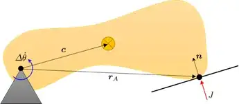

For posterity I am adding another answer, showing specifically how to handle a single constrained rigid body (pinned) under the influence of an impulse along a specified direction.
Consider a pined body with the center of mass at $\boldsymbol{c}$ and an impulse $J$ along the direction $\boldsymbol{n}$ at position $\boldsymbol{r}_{A}$. The pin is at the origin G, has direction $\boldsymbol{z}$ and speed $\dot{\theta}$. The center of mass is at point C, the contact at point A and the pin at the origin. The mass is m and the mass moment of inertia at the center of mass is $\mathcal{I}_{C}$.
fig1
Kinematics
$$\begin{aligned}\boldsymbol{\omega} & =\boldsymbol{z}\,\dot{\theta}\\ \boldsymbol{v}_{C} & =-\boldsymbol{c}\times\boldsymbol{\omega}=-\left(\boldsymbol{c}\times\boldsymbol{z}\right)\,\dot{\theta}\\ \boldsymbol{v}_{A} & =-\boldsymbol{r}_{A}\times\boldsymbol{\omega}=-\left(\boldsymbol{r}_{A}\times\boldsymbol{z}\right)\,\dot{\theta} \end{aligned} \tag{1}$$
and similarly for changes in speed, as in $\Delta \boldsymbol{\omega} =\boldsymbol{z}\,\Delta \dot{\theta}$, etc.
Dynamics
The impulse vector $\boldsymbol{J}=\boldsymbol{n}\,J$ at A causes a reaction impulse vector $\boldsymbol{G}$ at the pin, in addition to a reaction moment $\boldsymbol{\tau}_{G}$. The balance of momentum is thus $$\begin{aligned}\boldsymbol{G}+\boldsymbol{n}J & =m\,\Delta\boldsymbol{v}_{C}=-m\left(\boldsymbol{c}\times\boldsymbol{z}\right)\,\Delta\dot{\theta}\\ \boldsymbol{\tau}_{G}-\boldsymbol{c}\times\boldsymbol{G}+\left(\boldsymbol{r}_{A}-\boldsymbol{c}\right)\times\boldsymbol{n}J & =\mathcal{I}_{C}\Delta\boldsymbol{\omega}=-\mathcal{I}_{C}\boldsymbol{z}\,\Delta\dot{\theta} \end{aligned} \tag{2}$$
The above is 6 equations, with 7 unknowns (three impulse reaction forces, three impulse reaction torques and the joint speed).
Joint Condition
To solve the above we need one more equation. This comes from the power relationship of the joint. Namely power though a joint is defined as $P=\Delta\boldsymbol{\omega}\cdot\boldsymbol{\tau}_{G}+\Delta\boldsymbol{v}_{G}\cdot\boldsymbol{G}=0$ or for a pin joint since $\Delta\boldsymbol{v}_{G}=0$ and $\Delta\boldsymbol{\omega=z}\Delta\dot{\theta}$ the power expression is $$ \left(\boldsymbol{z}\cdot\boldsymbol{\tau}_{G}\right)\Delta\dot{\theta}=0 \tag{3}$$
The 7th equation is they key to solving this problem. Substitute $\boldsymbol{G}$ from the first equation in (2) into the second equation and solve for $\boldsymbol{\tau}_{G}$. The use this in the power equation.
$$\begin{aligned}\boldsymbol{G} & =-m\left(\boldsymbol{c}\times\boldsymbol{z}\right)\,\Delta\dot{\theta}-\boldsymbol{n}J\\ \boldsymbol{\tau}_{G} & =-\mathcal{I}_{C}\boldsymbol{z}\,\Delta\dot{\theta}-\left(\boldsymbol{r}_{A}-\boldsymbol{c}\right)\times\boldsymbol{n}J+\boldsymbol{c} \times\boldsymbol{G}\\ & =-\left(\mathcal{I}_{C}\boldsymbol{z}+\boldsymbol{c}\times m\left( \boldsymbol{c}\times\boldsymbol{z}\right)\right)\,\Delta\dot{\theta}-\boldsymbol{r}_{A}\times\boldsymbol{n}J\\ 0 & = \boldsymbol{z}\cdot\left(-\left(\mathcal{I}_{C}\boldsymbol{z}+\boldsymbol{c}\times m\left(\boldsymbol{c}\times\boldsymbol{z}\right)\right)\,\Delta\dot{\theta} - \boldsymbol{r}_{A}\times\boldsymbol{n}J\right)\\ & =-\left(\boldsymbol{z}\cdot\mathcal{I}_{C}\boldsymbol{z} +\boldsymbol{z}\cdot\left(\boldsymbol{c}\times m\left(\boldsymbol{c}\times\boldsymbol{z}\right)\right)\right) \,\Delta\dot{\theta}-\boldsymbol{z}\cdot\left( \boldsymbol{r}_{A}\times\boldsymbol{n}\right)J \end{aligned} \tag{5} $$
with the solution
$$\boxed{\Delta\dot{\theta}=-\left(\frac{\boldsymbol{n}\cdot\left(\boldsymbol{z}\times\boldsymbol{r}_{A}\right)}{\boldsymbol{z}\cdot\mathcal{I}_{C}\boldsymbol{z}+\boldsymbol{z}\cdot\left(\boldsymbol{c}\times m\left(\boldsymbol{c}\times\boldsymbol{z}\right)\right)}\right)\;J} \tag{6}$$
and the response to the impulse $$\begin{aligned}\Delta\boldsymbol{\omega} & =-\boldsymbol{n}\cdot\left(\boldsymbol{z}\times\boldsymbol{r}_{A}\right)\left(\frac{\boldsymbol{z}}{\boldsymbol{z}\cdot\mathcal{I}_{C}\boldsymbol{z}+\boldsymbol{z}\cdot\left(\boldsymbol{c}\times m\left(\boldsymbol{c}\times\boldsymbol{z}\right)\right)}\right)\,J\\ \Delta\boldsymbol{v}_{A} & =\boldsymbol{n}\cdot\left(\boldsymbol{z}\times\boldsymbol{r}_{A}\right)\left(\frac{\boldsymbol{r}_{A}\times\boldsymbol{z}}{\boldsymbol{z}\cdot\mathcal{I}_{C}\boldsymbol{z}+\boldsymbol{z}\cdot\left(\boldsymbol{c}\times m\left(\boldsymbol{c}\times\boldsymbol{z}\right)\right)}\right)\;J\\ \boldsymbol{G} & =-\left(\boldsymbol{n}-\boldsymbol{n}\cdot\left(\boldsymbol{z}\times\boldsymbol{r}_{A}\right)\,\left(\frac{m\left(\boldsymbol{c}\times\boldsymbol{z}\right)}{\boldsymbol{z}\cdot\mathcal{I}_{C}\boldsymbol{z}+\boldsymbol{z}\cdot\left(\boldsymbol{c}\times m\left(\boldsymbol{c}\times\boldsymbol{z}\right)\right)}\right)\right)\,J \end{aligned} \tag{7}$$
Contact Condition
If the impulse J is due to a contact with coefficient of restitution \epsilon then the law of contacts is $$\begin{aligned}\boldsymbol{n}\cdot\left(\boldsymbol{v}_{A}+\Delta\boldsymbol{v}_{A}\right) & =-\epsilon\,\left(\boldsymbol{n}\cdot\boldsymbol{v}_{A}\right)\\ \boldsymbol{n}\cdot\Delta\boldsymbol{v}_{A} & =-\left(1+\epsilon\right)\,\left(\boldsymbol{n}\cdot\boldsymbol{v}_{A}\right)\\ -\left(\frac{\left(\boldsymbol{n}\cdot\left(\boldsymbol{z}\times\boldsymbol{r}_{A}\right)\right)^{2}}{\boldsymbol{z}\cdot\mathcal{I}_{C}\boldsymbol{z}+\boldsymbol{z}\cdot\left(\boldsymbol{c}\times m\left(\boldsymbol{c}\times\boldsymbol{z}\right)\right)}\right)\;J & =-\left(1+\epsilon\right)\,\left(\boldsymbol{n}\cdot\boldsymbol{v}_{A}\right) \end{aligned} \tag{8}$$
Note that the impact speed is $v_{{\rm imp}}=\boldsymbol{n}\cdot\boldsymbol{v}_{A}=\boldsymbol{n}\cdot\left(\boldsymbol{z}\times\boldsymbol{r}_{A}\right)\,\dot{\theta}$, and the impulse is solved with $$\begin{aligned}\boldsymbol{n}\cdot\Delta\boldsymbol{v}_{A} & =-\left(1+\epsilon\right)\,\boldsymbol{n}\cdot\left(\boldsymbol{z}\times\boldsymbol{r}_{A}\right)\,\dot{\theta}\\ \boldsymbol{n}\cdot\left(\boldsymbol{z}\times\boldsymbol{r}_{A}\right)\left(\frac{\boldsymbol{n}\cdot\left(\boldsymbol{r}_{A}\times\boldsymbol{z}\right)}{\boldsymbol{z}\cdot\mathcal{I}_{C}\boldsymbol{z}+\boldsymbol{z}\cdot\left(\boldsymbol{c}\times m\left(\boldsymbol{c}\times\boldsymbol{z}\right)\right)}\right)\;J & =-\left(1+\epsilon\right)\,\boldsymbol{n}\cdot\left(\boldsymbol{z}\times\boldsymbol{r}_{A}\right)\,\dot{\theta}\\ \left(\frac{\boldsymbol{n}\cdot\left(\boldsymbol{r}_{A}\times\boldsymbol{z}\right)}{\boldsymbol{z}\cdot\mathcal{I}_{C}\boldsymbol{z}+\boldsymbol{z}\cdot\left(\boldsymbol{c}\times m\left(\boldsymbol{c}\times\boldsymbol{z}\right)\right)}\right)\;J & =-\left(1+\epsilon\right)\,\dot{\theta} \end{aligned} \tag{9}$$
and the required impulse for the bounce of $$\boxed{J=\left(1+\epsilon\right)\left(\frac{\boldsymbol{z}\cdot\mathcal{I}_{C}\boldsymbol{z}+\boldsymbol{z}\cdot\left(\boldsymbol{c}\times m\left(\boldsymbol{c}\times\boldsymbol{z}\right)\right)}{\boldsymbol{n}\cdot\left(\boldsymbol{r}_{A}\times\boldsymbol{z}\right)}\right)\,\dot{\theta}} \tag{10}$$
