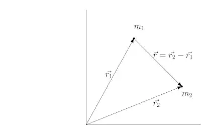

In a two body problem with say particles of masses $m_1$ and $m_2$ interacting under a central force $f(r)\hat{r}$ where $\mathbf{r} = \mathbf r_2 - \mathbf r_1$ the equations of motion of the two particles are $$m_1\ddot{\mathbf r}_1 = f(r)\hat{r}$$ $$m_2 \ddot{\mathbf r}_2= -f(r)\hat{r}$$ enter image description here

You started by implicitly putting the center of mass at the origin.
If you put $m_1$ at the origin you have changed the setup.
