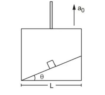

In the figure given below is block placed on an incline $\theta$. Now the lift is accelerating upwards with an acceleration $a_0$. Now if we make our measurements from the lift frame we will have to apply a pseudo force $-ma_0$. Which will have two components one in the direction of $Mg\cos\theta$. And other in the direction of $Mg\sin\theta$. Now $Mg\sin\theta+Ma_0\sin\theta=Ma_\text{net}$. Where $a_\text{net}$ is the net acceleration in that direction.
Now let's observe it from the ground or an inertial frame here the object has a net upward acceleration which has a component opposite to $Mg\sin\theta$. Therefore $Mg\sin\theta=- Ma_0\sin\theta$. Now what I thought was that this is not possible and hence there is another force acting opposite to $Mg\sin\theta$, $Ma_\text{net}$. Now this doesn't make any sense to me if there is a force acting opposite to $Mg\sin\theta$, and the net is also in that direction, then won't the object move upwards on the incline. Now that doesn't make any sense. Can someone tell me what Is happening and from where is this $a_\text{net}$ coming from when observing in the inertial frame?

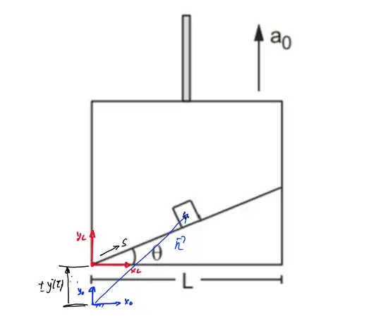

Perhaps you can see it better with this figure. enter image description here to apply NEWTON second law , you have to calculate the components of the position vector to the mass in inertial system.
$$\vec{R}= \pm\begin{bmatrix} x_0 \\ y_0 \\ \end{bmatrix}=\pm \left[ \begin {array}{c} s\cos \left( \vartheta \right) \\ s\sin \left( \vartheta \right) + y \left( \tau \right) \end {array} \right] \tag 1$$
where "+" from inertial system and "-" from lab system .
with equation (1) you can obtain the kinetic energy and with the potential energy $U=m\,g\,R_y$ you get the equation of motion:
$$M\,{\ddot{s}}\pm{M}\,g\sin \left( \vartheta \right) +{M}\,\sin \left( \vartheta \right) \underbrace{{\frac {d^{2}}{d{\tau}^{2}}}y \left( \tau \right)}_{a_0} =0$$
thus for "+" sign you get $$M\,a_{\text{net+}}=M\,g\,\sin(\vartheta)+{M}\,\sin(\vartheta)\,a_0\quad \Rightarrow\quad g\mapsto g+a_0$$
and for "-" sign you get:
$$M\,a_{\text{net-}}=-M\,g\,\sin(\vartheta)+{M}\,\sin(\vartheta)\,a_0\quad \Rightarrow\quad g\mapsto a_0-g$$

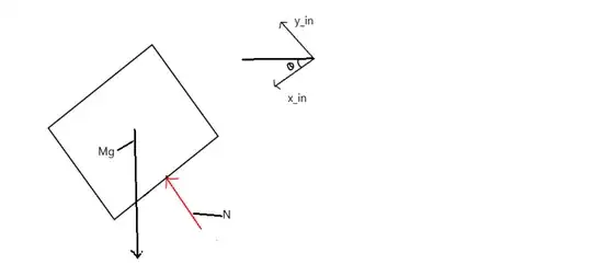

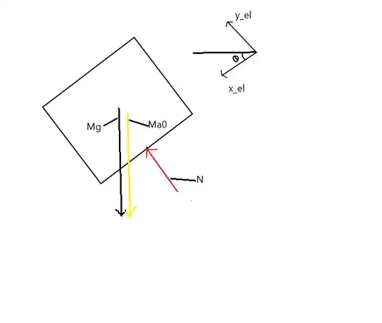

In the first part of your question you are looking at the frame of the elevator. Since the frame is accelerating, you have an $Ma_0$ pseudo force in the downward direction. So the free body diagram looks like enter image description here
You used $a_{net}$ for acceleration along plane but I'm using $a_{x_{el}}$ because its a component of acceleration not the net acceleration. So the force equation along the incline (along $x_{el}$) is $$MgSin\theta+Ma_0Sin\theta=Ma_{x_{el}}$$ canceling $M$ gives us $$a_{x_{el}}=gSin\theta+a_0Sin\theta$$ If you look perpendicular to the incline $$a_{y_{el}}=0$$ as the incline is stationary in the frame of the elevator and the block does not have any acceleration perpendicular to the incline when its stationary. Upto this part you got it right. I Don't know what you did in the second part. w.r.t inertial frame, $MgSin\theta \neq-Ma_0Sin\theta$.
Anyway, looking from the inertial frame, the free body diagram looks like thisenter image description here Notice there is no component of a pseudo force due to $a_0$ in this frame as it is inertial. The force equation along the incline is $$MgSin\theta=Ma_{x_{in}}$$ therefore $$a_{x_{in}}=gSin\theta$$ This is because only force acting on it along the incline (along $x_{in}$) is gravity. That is the acceleration of the block along the incline in the inertial frame. So you might ask what difference does this make from a system in which incline is stationary. The difference is in this system, the acceleration of the block perpendicular to the incline has to be equal to the component of the acceleration of the elevator(and therefore the wedge the block is on) perpendicular to the incline. That is, $$a_{y_{in}}=a_0Cos\theta$$ Otherwise if the block and the incline didn't have the same acceleration in the $y_{in}$ direction they would separate or the block would go into the incline.
