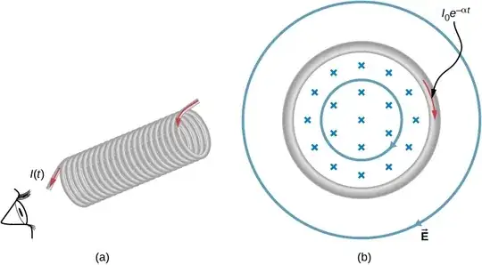

Let us suppose there is a solenoid which has $n$ turns per unit length the current is varying with time as $I =kt$ where k is a constant if the current is flowing then there must be induced electric field inside and outside the solenoid since $$\oint E_{induced}.dl= -\frac{d\phi}{dt}$$. now my question is if I place a small charge anywhere inside or outside the solenoid will it move with the induced electric field in a circle?The induced field is in blue color. Please ignore the current equation in the image. The induced electric field is in blue.please ignore the current equation in the figure.

Yes, the charge will move under the influence of the induced E-field, but it will not move in a circle: this would require a centripetal force, but there is none. Instead, the (positive) charge will start to move in the direction of the E-field, then spiral outward.

Yes, this is exactly what causes inductive coupling.
