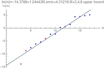

The (15 positive) masses of fundamental particles are measured inputs to the standard model. They seem to increase exponentially when ranked in increasing order, or perhaps follow a power law when ranked in decreasing order. The masses (in GeV/c^2) are approximately:
0, 0, <.000001, <.00017, .000511, .0022, .0047, <.0182, .096, .10566, 1.28, 1.7768, 4.18, 80.39, 91.19, 124.97, 173.1
where the inequalities are upper bounds for the unknown neutrino masses. I don't want to stray too far into numerology, but when the logarithm is plotted (excluding the photon and gluon) you get a pretty straight line (-14.3788+1.24443n):
log particle masses
I'm aware of the Koide formula, but haven't heard of this little phenomenon before. Does the Standard Model have anything to say about this, perhaps bounds on the masses, or are these really just coincidences that will only be explained when there is a deeper theory?

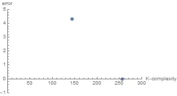

EDIT: To address the comments, I've removed the two gaps I put in by hand where there are subjective jumps between particles 10 and 11, and particles 13 and 14. The masses are in rank order, which is unique up to ascending or descending. I have also included the norm of residuals as the 'error'. To be clear, this is an approximation. The Kolmogorov complexity of the complete list (upper bound computed using Mathematica, $ByteCount[Compress[list]]$) is approximately 256, with an error of 0 (really a small positive $\epsilon$) using that description. With this description, the K-complexity is approximately 112, and the error is 4.31219. The comments seemed to imply that if you allow gaps, one could bring the error to zero. However, there is a cost in K-complexity. Here is a plot:
K-complexity v. error
EDIT 2: To address a comment, I have colored the upper bounds for the neutrino masses to clarify that they are unknown. This increases the K-complexity of the description from 104 to 144.
First off, the right part of the graph is not really contributing anything: the $W$-boson, $Z$-boson, and Higgs boson all have mass in the same range, because these masses all come from the scale of electroweak symmetry breaking. Similarly, the left part isn't saying much, because everything is zero or too low to measure. So we're left with the $6$ quark and $3$ charged lepton flavors.
Explaining their masses is known as the flavor problem. Unfortunately, even though it really seems like there's something going on here, nobody has succeeded in writing down a compelling theory. Literally thousands of attempts have been made, but the resulting models generally are quite contrived, and either don't make any sharp and reasonably testable predictions, or make incorrect predictions. So most of these models don't attract much attention, for the same reason the Koide formula doesn't -- they're interesting, but it's not clear what more we can do with them.

The problem of this presentation is that it uses particles not showing the entry (neutrinos) as upper bounds, and for quarks, these are values at an arbitrarily chosen scale of $2~\rm GeV$: - the masses at $1~\rm GeV$ or $3~\rm GeV$ would also be interesting so really for up-quark=$.0022\pm 100\%$, down-quark=$.0047\pm 90\%$, strange quark= $.10566\pm50\%$, Charm-quark=$1.28\pm30\%$. So a plot as presented done correctly can be fitted by any monotonic function (monotonic since ordering is with mass value, thus arbitrary). Oh, I forgot to mention that bottom quark has ist problems to, any value between 3.5 and 5.5 GeV will make everyone happy..... So all we learn here is that if one orders numbers in sequence of value the resulting function is monotonic. And if I can be of help to anyone looking at W/Z (80/90 GeV, take geometric mean), Higgs (124) and top (174) please remember that there is a surprize: these are indeed in geometric progression with $\sqrt{2}$ factor and on top of evrything the minimal coupling of top is 1. So we know the Standard Model has a secret for us, many are looking to solve the riddle and travel to some nordic country in December.
