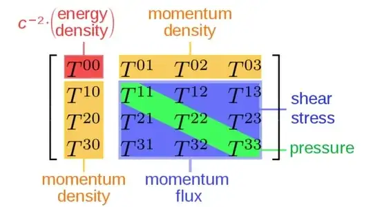

However, in General Relativity, gravity isn't just caused by the amount of energy (including rest mass energy) in a region. The Einstein field equations say that the spacetime curvature is due to the stress-energy-momentum tensor.
So to properly calculate the gravity as a black hole forms we also need to include the effects of pressure, momentum density, momentum flux, and shear stress.
