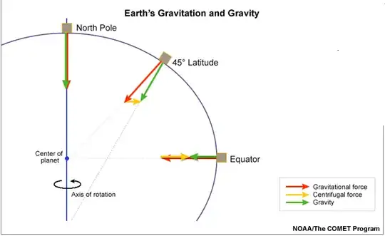

Look at this image of the earth.
(image from Gravity for Geodesy I: Foundations)
- The gravitational force (red arrow) points to the center of the earth.
- The centrifugal force (yellow arrow) points away from the axis of rotation.
- The total force (green arrow) is the vector sum of the two above. In general (except at the poles or at the equator) it does not point to the center of the earth, as you already pointed out in your question. The earth will deform in such a way that the surface is perpendicular to the total force, hence resulting in the ellipsoid form.
