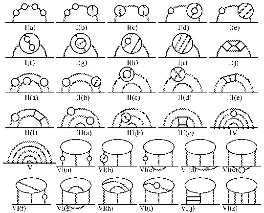

If you want to predict the anomalous magnetic moment of the muon, which has been measured to better than 7 digits, you need to consider thousands of terms involving various intermediate states:
each of which is critical to getting the correct answer.
So virtual particles are a phenomenal tool for designing experiments or understanding processes whose exact quantitative nature are intractable, where they are not useful is in describing static field configurations.
