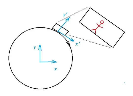

A simple but incomplete answer, by means of an example.
A train carriage moves with uniform speed and clockwise on a circle:
Frame of reference
The reference frame $(x,y)$ certainly allows adequate and easy description of the velocity vector and forces (vectors) acting on the carriage.
But assume that inside the carriage is a person who is throwing a ball, maybe upward or downward or forward or backward (it doesn't matter really).
It should be intuitive that $(x,y)$ is a nightmare to describe the ball's physics (kinetics, forces) with. Another reference frame, $(x',y')$, this one attached to the moving carriage is far more suited to that.
This situation is common: we all sit on a sphere rotating about the Earth's $\text{NS}$ axis and trains with people in them move on it in all directions.
