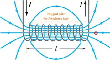

The figure and the equation in the following description are borrowed from Wikipedia's description of solenoid coil article. However, the red circle in the figure was added by me. And am using diffrent unit system.
Suppose we have a solenoid coil with an iron core as shown in the figure (although the iron core is not explicitly depicted in the figure).
Solenoid coil of Wikipedia
The magnetic flux density $\vec{B}$ in the iron core is expressed by the following equation (see Wikipedia), \begin{equation} B_{\text{iron}}=\mu_0\mu_r\frac{NI}{l},\tag{1} \end{equation} where $B_{\text{iron}}$ is the magnetic flux density in the iron-core, $l$ is the length of the solenoid, $\mu _{0}$ is the magnetic permeability of vacuum, $\mu_r$ is the relative magnetic permeability of iron, $N$ the number of turns, and $I$ the electric current.
In Equation (1), some of the physical quantities are directly measurable. The current $I$ can be measured with an electric circuit ampere meter. Direct measurement of $B_{\text{iron}}$ may be very difficult, but from our knowledge of Maxwell's equations, we know that the normal component of B is continuous inside and outside the iron. Thus \begin{equation} B_{\text{iron}}=B_{\text{space point}}, \tag{2} \end{equation} where the space point is a point very close to the iron core and at the center axis, an example of this space point is the red circle point in the figure. $B_{\text{space point}}$ can be measured with a magnetometer.
From equations (1) and (2), $\mu_r$ can be calculated: \begin{equation} \mu_r=B_{\text{space point}}\frac{1}{\mu_0}\frac{l}{NI} \tag{3}. \end{equation} The result of this calculation can be regarded as a measurement. Thus, \begin{align*} H_{\text{iron}}&=\frac{B_{\text{iron}}}{\mu_0\mu_r}=\frac{NI}{l},\tag{4} \\ \mu_0M&=B_{\text{iron}}-\mu_0H_{\text{iron}}=\mu_0(\mu_r-1)\frac{NI}{l},\tag{5} \end{align*} where $H_{\text{iron}}$ is the magnetic field and $\mu_0M$ (or $M$) is the magnetization of iron core.
Of course, this measurement method has a large measurement error, so the actual measurement method needs to be devised.
