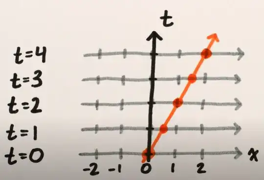

I'm watching this minutephysics video on Lorentz transformations (part starting from 2:13 and ending at 4:10). In my spacetime diagram, my worldline will be along the $ct$ axis and the worldline of an observer moving relative to me will be at some angle w.r.t. the $y$ axis.
When we switch to the other observer's spacetime diagram, the observer's worldline will be along the $y$ axis and my worldline would flip over to the other side, but the angle between the worldlines would be preserved. Then the video goes on to mention three possibilities:
The even at $(2,4)$ ends up getting mapped to $(0,T)$, where $T<4$, $T=4$ or $T>4$. And it seems like the video is suggesting only one possible transformation for each case, giving a total of only three possible transformations. For an angle preserving transformation $A$, given any two unit vectors $u_1,u_2$,
