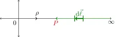

But here's the tricky part. That last equation actually involves two different variables. The $\mathrm{d}\vec{r}$ on the left side is a differential that represents an infinitesimal progression along the path of integration (what might be otherwise denoted $\mathrm{d}\vec{\ell}$ or $\mathrm{d}\vec{s}$), while the $r$ on the right side is a coordinate which measures distance from the origin (what might otherwise be denoted $\rho$, or $x$ if you're integrating along the $x$ axis, or so on).
a small coordinate axes showing rho increasing to the right and l pointing to the left
So to avoid confusion, you might want to write $$\mathrm{d}\vec{\ell} = -\lvert\mathrm{d}\rho\rvert\hat{\rho}$$ Now, as you step along the line of integration from $\infty$ towards $P$, $\rho$ decreases. So if you're going to do a change of variables to replace $\mathrm{d}\vec{\ell}$ with its expression in terms of $\rho$, you're going to need $\mathrm{d}\rho < 0$, which in turn means that $\mathrm{d}\vec{\ell} = \mathrm{d}\rho\,\hat{\rho}$. Therefore, $$\int_{\infty}^{P}\vec{F}\cdot\mathrm{d}\vec{\ell} = \int_{\rho=\infty}^{\rho=r_P}\biggl(-G\frac{Mm}{\rho^2}\hat{\rho}\biggr)\cdot(\mathrm{d}\rho\,\hat{\rho})$$ The difference with what you were trying to do was that you assumed $\mathrm{d}r$ (non-vector, after the dot product) would be positive. That $\mathrm{d}r$ actually corresponds to $\mathrm{d}\rho$, and is negative. Roughly speaking, you implicitly did a change of variables from $\ell$ to $\rho$, which introduces a sign change, but it was hidden from you because you used the same letter ($r$) for both variables.
