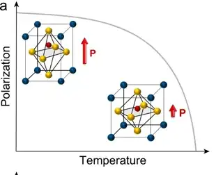

I know that Pyro-electricity is due to an asymmetry of position of negative and positive ions in the crystal structure, such that when thermally dilatated a net polarization is created along some direction. Pervoskite is one such crystal structure that permits this:
                                            \text{Pervoskite structure under pyro-electric effect}

I think crystal structure (https://en.wikipedia.org/wiki/Pyroelectricity) explains this. Say if the pervoskite (which is pyro with natural polarisation P) red atom jumps from upper half to lower half of gold enclosure and polarisation reverses to downward direction when applying an electrical field, then it is ferroelectric too, otherwise only pyroelectric. So perhaps it is an electric potential energy barrier issue that determines ferroelectricity of a polar crystal which is always pyro.
Note, this assumes stable reversal. High intensity and / or short-lived reversals can happen and if observed can settle your disquiet.
