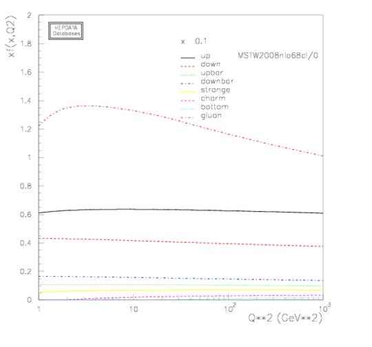

At large $x = 0.1$, they're fairly constant over a range of $Q^2$.
large-x PDFs

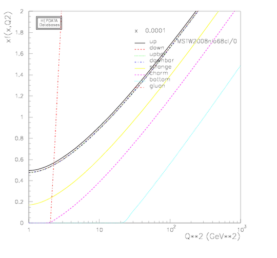

But at small $x = 10^{-4}$, they rise quickly with $Q^2$:
small-x PDFs
This is an illustration of Bjorken scaling at large $x$ and its breaking at small $x$.
I'd also mention that the $Q^2$-dependence of the PDFs is predicted from QCD by the DGLAP equations, so you can look at those to further understand the behavior.

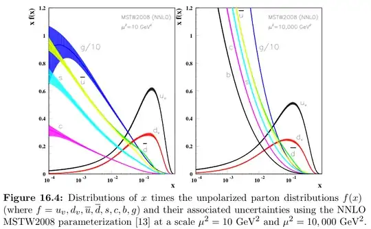

As usual the review of particle physics has some useful figures.
From the 2011 edition the chapter on Structure Functions (PDF link) has this figure enter image description here which is not quite the bounds you asked for but does show considerable change.
