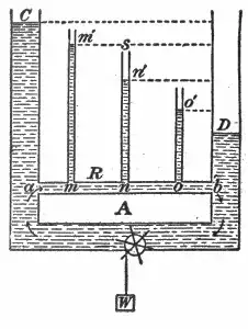

Perhaps I can clarify what I'm trying to get at with the famous waterwheel analogy
99 years ago, Nehemiah Hawkins published what I think is a marginally better analogy:
Fig. 38. — Hydrostatic analogy of fall of potential in an electrical circuit.
Explanation of above diagram
  • In this diagram, a pump at bottom centre is pumping water from right to left.
  • The water circulates back to the start through the upper horizontal pipe marked a-b
  • The height of water in the vertical columns C,m',n',o',D indicates pressure at points a,m,n,o,b
  • The pressure drops from a to b due to the resistance of the narrow return path
  • The pressure difference between a and b is proportional to the height difference between C and D
Analogy
  • Pump = Battery
  • Water = Electric charge carriers
  • Pressure = Voltage
  • Vertical Pipes = Voltmeters
  • pipe a-b = Resistor (or series of four resistors)
Note
  • A "particle" of water at a has a higher potential energy than it has when it reaches b.
There is a pressure drop across a "resistive" tube.
Voltage (electric potential) is roughly analogous to water pressure (hydrostatic potential).
If you could open a small hole at points a,m,n,o,b in the tube and hold your finger against the hole, you would be able to feel the pressure at those points is different.
The potential at some point is the amount of potential energy of a "particle" at that point.

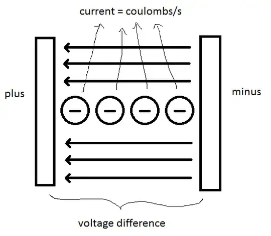

Here's a drawing I made for you:
Drawing of current
I drew it as it really is, against the convention. Notice that, despite there being a pre-existing voltage difference between the two batteries, the distribution of electrons is uniform. So, if you tried to take a voltage difference between the first electron and the fourth electron, you get a voltage difference of zero, even if they are flowing, because their distribution will continue being uniform. This, I think, is the equivalent of measuring the voltage across a wire with no resistor.

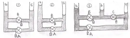

The first thing to note is that you must never use the word voltage unless you are sure that you and your audience are aware of the fact that is shorthand for “a difference in voltage” or as you have used “voltage drop”.
I would prefer to use the term “potential difference”.
All this has to do with energy and a type of energy that a system has which makes it capable of doing work which is called potential energy.
The water circuit is a very good analogue of an electrical circuit but let me modify it a bit in the following way.
In diagram 1 here is no friction and $A$ and $B$ are “pumps” with built in taps.
All of the taps are open but none of the pumps are working.
What happens next? – Nothing, as the system is in its lowest gravitational potential energy state.
Does that mean that the water has no gravitational potential energy ie cannot do any work.
No. You can say it has gravitational potential energy because it could do work when falling onto the bench top which is below the apparatus but it is not allowed to do that in this case.
Close tap $B$ and let the weight attached to pump $A$ fall.
What happens? – In diagram 2 the water level in tube $a$ goes up and the water level in tube $c$ goes down
Pump $A$ is doing work on the water.
How is it doing that? - There is a weight attached to the pump’s shaft and the weight is falling.
So what is it that makes the water flow? - The falling weight losing gravitational potential energy and so the pump does work on the water.
The water in tube $a$ is gaining gravitational potential energy and the water in tube $c$ is losing gravitational potential energy.
There has been a conversion of the gravitational potential energy of the weight to the gravitational potential energy of the water and there is a net gain in the gravitational potential energy of the water.
When the difference in water level between tubes $a$ and $c$ reaches a certain value the pump stops and tap $A$ closes.
Tap $B$ is now opened.
Water flows through pump $B$ from tube $a$ to tube $c$ raising the weight attached to pump $B$ until the water levels in tube $a$ and tube $c$ are the same.
Pump $B$ has done work and the gravitational potential energy of the water has been converted into the gravitational potential of the weight.
In diagram 3 a third pump and tap $C$ have been added.
All the taps are open with pump $A$ maintaining a constant difference in water level between tube $a$ and tube $c$.
Pump $A$ is continually doing work and the net result is the increase of the gravitational potential of the water going from tube $c$ to tube $a$ and the decrease of the gravitational potential energy of the falling weight.
Pump $B$ is continually doing work and the net result is the increase of the gravitational potential energy of the falling weight attached to it and the decrease of the gravitational potential of the water going from tube $a$ into tube $b$.
Pump $C$ is continually doing work and the net result is the increase of the gravitational potential energy of the falling weight attached to it and the decrease of the gravitational potential of the water going from tube $b$ into tube $c$.
The essence of your question is “What is different about the water in tube $a$ and the water in tube $b$?”
The answer is “The water in tube $a$ can do more work than the water in tube $b$.”
The water in tube $a$ lifts the weights attached to both pump $b$ and pump $c$ whereas the water in tube $b$ only lifts the weight attached to pump $C$.
Now to translate all this into electrical terms.
To make it easier just assume that in my electrical circuit the mobile charge carrier are positive as I find it easier to visualise positive charge wanting to falling down a (potential) hill as opposed the electrons wanting to climb up a (potential) hill.
In diagram 4 pump $A$ is battery $A$ and pumps $B$ and $C$ are motors $B$ and $C$.
The battery is a device which raises the electrical potential energy of the mobile charge carriers when they move from node $c$ to node $a$ (the increase in water level).
This comes from a chemical reaction in the battery and a decrease in chemical potential energy (the falling weight.
Motors $B$ and $C$ are devices which do work raising weights at the expense of a decrease in the electrical potential energy of the mobile charge carriers passing through them.
Rather than use the term “change in potential energy between two points” all the time it is easier to use the term “change in potential energy between two points per unit charge” and even simpler still “potential difference between two points” or “potential difference” or your term “voltage drop”.
So when you have a voltage drop across a component it is telling you that the amount of work the mobile charge carriers can do on leaving the component is reduced (drops) compared with the amount of work the mobile charge carrier can do before entering the component.
The amount of work (joules, J) which can be done by unit charge (1 coulomb, 1C) of mobile charge carriers between two points, the potential difference between those two points, is measured in joules per coulomb which is the volt.
Diagram 5 is a simple circuit.
The voltage drop across the 3$\Omega$ resistor is 3V.
Starting at node $a$ and finishing at node $c$ 1 coulomb of mobile charge carriers will produce 5 joules of heat whereas if they started at node $b$ and reached node $c$ they would only have generated 2 joules of heat.
So one coulomb of mobile charge carriers capacity to do work has fallen from 5 joule at node $a$ to 2 joules at node $b$ a drop of 3 joules per coulomb which is a voltage drop of 3 volts.
