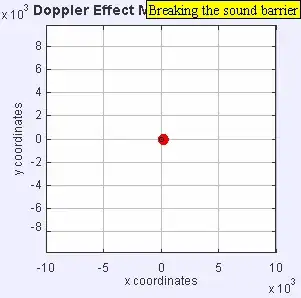

This asymmetry is best understood analyzing the case when the source moves towards the receiver approximately at wave propagation speed $c$. Then the Doppler ratio will be $$ \frac ff_0 = \frac {c}{c-c} = \infty $$
It means that receiver will not register any waves until the source will arrive fully at the receiver, and then the receiver will experience an immediate huge shock wave with infinite frequency. It looks like:
Enter image description here
I thought very long about the best analogy to this situation. I think this would be best understood by a tsunami, which is caused, say, by an under-water earthquake. The earthquake pressure wave (source) travels towards the coast at the sea waves' speed, and thus each wavefront adds to another, raising the forward wave amplitude, until it crashes the coast with enormous shock wave power.
Now imagine you want to get the same tsunami collision energy only by moving yourself (receiver) in the ordinal sea waves. How fast should you be going? Probably your speed should be very high, so that you could be hitting many ordinal waves per second. Returning back to mathematics, for getting the same infinite Doppler ratio, but just in case of the receiver moving towards the source, the equation must be:
$$ \frac ff_0 = \frac {c+\infty}{c} = \infty $$
In other words, you need to move at infinite speed.
