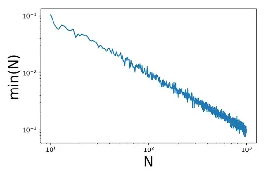

If you code a little, you can play around yourself: throw $N$ random numbers according to any distribution and take the minimum of these. You can average over several independent runs, and get the average minimum value out of $N$ random numbers. Then see how this average minimum value changes with $N$. Below is a small Python code that just does that:
import numpy as np
import pylab as pl
min_N = [] for N in range(10,1000): min_current = 0 for realizations in range(100): min_current+=np.min(np.random.rand(N))/100.0 min_N.append(min_current)
pl.loglog(range(10,1000), min_N) pl.xlabel('N', fontsize=22) pl.ylabel('min(N)', fontsize=22)
and the result:
So now you can see that the minimum of $N$ uniformly distributed random numbers (i.e. the strength of the chain) decreases with $N$. This is a log-log plot so looks like it decreases as a power law.

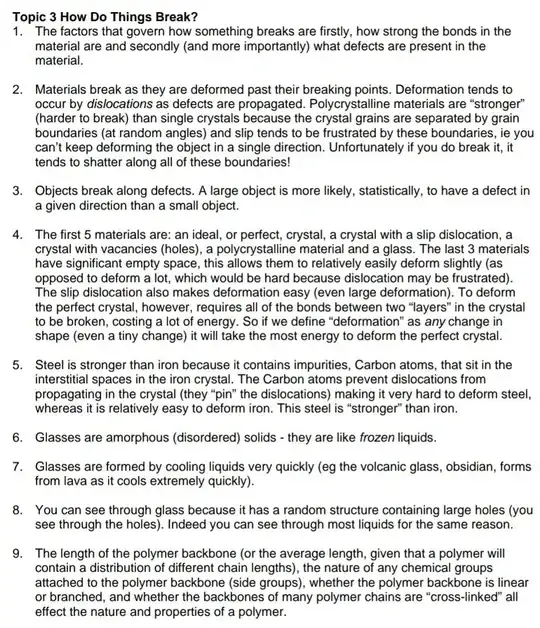

APPROACH 1:- Development of cracks and breakage points pave the way to breaking. An important process in breaking is the propagation of those cracks and breakage sites through the lattice (or the propagation of dislocations through the lattice) Now, larger objects have more probability of development more irregular arrangements or more defects in a direction as compared to small objects as they would have a longer or more expanded arrangement. So, it creates more probability for defects. As large objects have more defects, they will be more suitable for the propagation of cracks or dislocations. Hence, they are more likely to break. Similarly, you can ask why some materials break more than other. Here is an additional info. for you:- enter image description here
