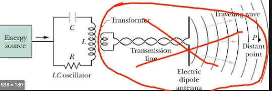

Just shown as the above picture, if the right part removed, would electromagnetic waves still be produced near the inductor and what the changing electromanetic field are in this situation? I used to watch some video to explain EM waves by the similar circuit, in witch he says the EM waves could not detached from the circuit if there is no antenna, I don't believe the EM waves are detached from the circuit, the word detach is really confusing. I do believe the LC circuit without antenna will propagate less energy out but don't know why. Could Maxwell's Equations help to modeling all these situation?

...if the right part removed, would electromagnetic waves still be produced near the inductor and what the changing electromanetic field are in this situation?
Every accelerated electron emits EM radiation. If you operate an LC circuit with its oscillating current, the electrons are accelerated back and forth and emit photons. In addition, the charges in the inductor undergo a circular (more precisely, helical) movement, which causes the electrons - an acceleration even in direct current - to radiate. To cut a long story short: When you start an electric current, you lose energy in the form of emitted photons.
I used to watch some video to explain EM waves by the similar circuit, in witch he says the EM waves could not detached from the circuit if there is no antenna,...
This is a technical view of what is happening. A radio engineer is interested in getting a strong signal from an antenna. Of course he cares about losses within the electronics, but the "real" radio wave is the only thing he needs. Even an LC-circuit with a lousy efficiency radiates radiation, whether the antenna has the right length (resonant to the wave generator) or not.
It all depends on the effective resistance of the circuit. The resistance is responsible for the energy losses, be it the radiated radio wave or the heat radiated by all elements of the circuit. Whether an LC circuit without an antenna connected to it loses more or less energy than with, it depends on the components, frequency and power of the generator.

An antenna radiates more energy than the plates of a capacitor; the radiation resistance of a capacitor and wires is small, therefore it is not as efficient at radiating energy like an antenna, and a lot of power would have to be driven into the circuit to radiate the same amount of power that a dipole would due to the poor efficiency and directivity. The radiation resistance becomes greatest when the element is the length of a wavelength, and due to this you'd get the greatest radiation efficiency compared to the loss resistance.
