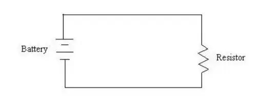

If you have a circuit with one battery and one resistive element, like a resistor or a lightbulb, like this:
Circuits are typically modeled with ideal wires, which have no resistance. That means that in this situation, if the battery is 3V, then every point in the wire between the (+) terminal of the battery and the "upper" terminal of the resistor is 3V. At the resistor, you see a voltage drop of -3V. Then, from the bottom of the resistor back to the (-) terminal of the battery, every point is 0 volts. So in this very simple circuit, the wires are held at two distinct potentials.
In reality, wires do have resistance and dissipate energy through heat, but this is very small, so it is a good approximation in many applications to model the circuits with ideal wires.
