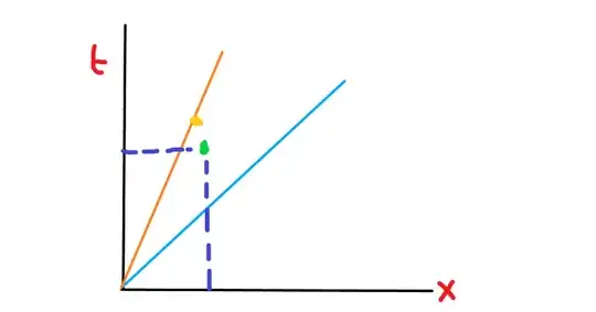

In Special Relativity, we use something known as a spacetime diagram. It looks like this:
Now, here we are only looking at 1 dimension of space and dimension of time. The green dot represents and event, that takes place at some point in space, and at some point in time. In this diagram, every object can be viewed as a worldline (see the orange line), and the slope of the worldline gives the speed of the object. The blue, diagonal line you see represents the speed of light. Now any line left to the blue line is called timelike, and any line to the right is called spacelike. The blue line itself is sometimes called 'null'.
Timelike worldlines represent objects with velocity less than $c$, while spacelike ones represent objects with velocity higher than $c$. As nothing can travel faster than light, spacelike worldlines are impossible.
Now if you have a pure timelike worldline, that means your worldline lies on the time axis. Mathematically, that corresponds to $$ds^2 = dt^2 - 0 = dt^2$$ (where $ds$ is the spacetime interval). But when you have a moving object, travelling relative to you, they can argue that they are at rest and you are moving, so your spacetime interval (according to them) would be: $$ds^2 = dt^2 - dx^2$$ which means in their reference frame, your worldline is not purely timelike. So, being purely timelike is not an invariant.
Now, when you generally say timelike, you mean any worldline to the left of the blue line. Which corresponds to you having velocity less than that of light.
Now, if there is an moving observer, they will agree that your worldline is timelike, because your worldline has to lie somewhere in that region (otherwise they would see you moving faster than light, which leads to all sorts of problems). So the fact that your worldline is timelike is invariant, but the fact that the particular worldline you observe is the one also observed by everybody else is not. So in the first case, the moving observer will agree that your worldline is timelike, but will not agree that it is completely (purely) timelike (that is basically lies on the time axis).
