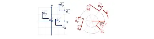

two dimensional flat space:
In this video the covariant derivative in flat space was explained as just taking the ordinary derivative, but doing it properly (i.e. taking into account, that the derivatives of the basis vectors are not necessarily zero). For example in Cartesian and polar coordinates:
$$\frac{\partial \vec{e}_x}{\partial x}~=~\frac{\partial \vec{e}_x}{\partial y}~=~0~~~~~\text{but}~~~~~\frac{\partial \vec{e}_\theta}{\partial \theta}~=~-r\vec{e}_r~,~\frac{\partial \vec{e}_\theta}{\partial r}~=~\frac{1}{r}\vec{e}_\theta$$
Here the basis vectors are not normalized, so $\vec{e}_\theta = \partial \vec{R}/\partial \theta$, etc. This derivative can then be computed, by expanding $\vec{e}_\theta$ in Cartesian coordinates and using, that the Cartesian basis vectors are constant, which leads to the results on the right. So to show, that $\vec{e}_\theta$ is not constant, it was necessary to know, that $\vec{e}_x$ and $\vec{e}_y$ are constant.
At first this did seem weird to me. Why can I objectively say, that $\vec{e}_x$ is constant, but $\vec{e}_\theta$ is not? I can expand $\vec{e}_x$ in polar coordinates and suddenly it does not look constant at all. Now the solution of this is propably obvious: As soon, as I don't think about the vectors in purely abstract terms, it is clear, that $\vec{e}_\theta$ does physically change its direction, while $\vec{e}_x$ does not.
I could print out a large version of the coordinate systems in the picture above and put it on the floor of my room, with the origin being in the center. Now when I start walking in $\vec{e}_x$-direction and keep walking in a straight line, it does not really matter, from what point in my room I start walking. I can start from some point A and after some time I will arrive at say the football stadium. The next day I can start from a different point right next to A and I will still arrive at the football stadium. The two straight lines, that mark my ways on the two days are parallels. The distance between them does not change, so in the end I will arrive at points that are still right next to each other. That is not the case, if I follow the directions of $\vec{e}_\theta$ at two different points close to each other. In this case, starting from point A and going straight into the direction at which $\vec{e}_\theta$ points, might still take me to the football stadium, but starting from a point right next to A and following the dirction of $\vec{e}_\theta$ from there, might bring me to the cathedral. Basically I am saying: I can see the real difference in the change of $\vec{e}_\theta$, beacause I can attach a straight line, and see where it leads me.
The only problem is: How do I know, if I am following a straight line, while walking away from my room? In flat space and with Newtonian physics this is easy and there are many ways:
1) I can just trust my eyes: I keep the stadium in the center of my field of view. Because I know, that the light coming from the stadium moves on a straight line, I know, that I myself am moving on a straight line, when I always see the stadium right in front of me.
2) I could use Newton’s first law of motion: If I just accelerate one time at the beginning and there are no forces acting on me (neglecting friction, wind and so on) I can be sure, that I will not change direction and therefore move on a straight line.
3) I could take a string and attach one end to my room and the other one to the stadium. When the string ist streched, I know that the line is straigth, because a straight line is the shortest path between two points.
To sum up: When I want to know if a vector field is constant or not and I have been given the vector field in non-Cartesian coordinates, I have to take into account, that my basis vectors may be changing their direction, depending on their position in space. I can understand this, because I can grasp what changing direction means. And I can understand what changing direction means, because I can define straight lines.

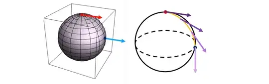

A two dimensional curved surface in three dimensional flat space
The next step is to formulate derivative for people living on a curved surface, e.g. the earth. How would a constant vector field for somone living on the surface look like?
Looking from space, we see, that the two vectors on the left hand side in the picture above point in the same direction (e.g. some fixed star). But for someone on the surface those two vectors are very different because the one at the north pole points forward along the surface, but the one at the equator just points out of the surface. Walking down from the north pole to the equator, the vector field on the right hand side does look way more constant, than the one on the left. If the vector field is a kind of force, say the wind, it would have the same effect on the person every step of the way, namely providing some momentum by tailwind.
The covariant derivative takes this into account by subtracting the component normal to the surface from the rate of change of the vector field:
$$\nabla_{\vec{e}_i}\vec{v}=\frac{\partial \vec{v}}{\partial x^i}-\vec{n}~=~\left[\frac{\partial v^k}{\partial x^i}+v^j\Gamma^k_{ij}\right]\vec{e}_k$$
Where the $\Gamma^k_{ij}$ are the Christoffel-symbols which give the rate of Change of basis-vectors tangent to the surface:
$$\frac{\partial \vec{e}_j}{\partial u^i}~=~\Gamma^k_{ij}\vec{e}_k+L_{ij}\hat{n}$$
