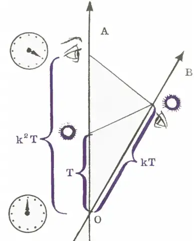

The Bondi k-calculus uses the radar method [using light signals and clocks (wristwatches)] to express the square-interval operationally as a product of time-intervals involved in the radar measurements (resulting in a variant of the expressions used by Robb).
[$k$ refers to the Doppler factor, an eigenvalue of the Lorentz transformation. Bondi is essentially (i.e. secretly) working in light-cone coordinates. The standard form of the Lorentz Transformation and the $\gamma$-factor are delayed, and are not explicitly needed to obtain the results Bondi obtains.]
When the square-interval is expressed in rectangular coordinates, you obtain the Minkowski signature.
I think the best readable reference for this method is Bondi’s Relativity and Common Sense. https://archive.org/details/RelativityCommonSense Bondi-k-calculus
You can see a summary of Bondi’s method here: https://physics.stackexchange.com/a/508251/148184 https://www.physicsforums.com/insights/relativity-using-bondi-k-calculus/
