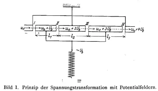

I will give a shot at answering the question. From my perspective, the LHC is a direct descendant of Wideroe's proposal for the linac (Archiv fur Electrotechnik, Vol 21 p 387 (1928)). His illustration for the general idea of the linac is:
Ions enter from the left. If the rf voltage across gap I is right, the ion will be accelerated across the gap and then fly into the field-free tube to the right. This tube is of the right length for the ion charge/mass so that when they hit gap II they are nicely in phase to be accelerated, again, by the rf voltage. This continues on and on, steadily increasing the ion voltage using a single rf power supply.
But, if the ions hit at the "wrong" time, they will find a smaller field across gap I, or even a reversed field, and will not get enough energy to hit gap II at the right time. Only ions in a narrow time window will manage to get to, and across, each gap with the right energy to make it to the next gap. Historically, for the early linacs, if fed with a continuous beam of ions you would get ~1% through the linac. This can be improved by "bunching" the incoming beam to turn the continuous beam into a series of bunches, where each bunch hits gap I at the right time.
Now a circulating machine is a bit more difficult, but ultimately you still need bunches of ions/electrons hitting the accelerating gaps at just the right time to steadily increase the beam energy. If you look at a current monitor you would see a series of blips as the bunches fly by. Any difference in the charge in a bunch can be seen, so you can track the progress of individual bunches around the machine. And, you need to keep track of them since the timing of each gap has to be kept in synch with the beam or else you lose beam.
