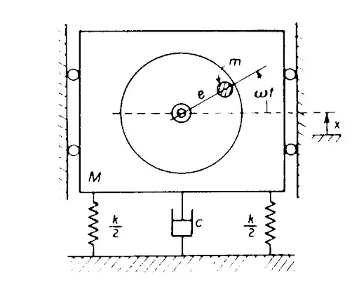

For a simple example consider the classical single degree of freedom rotating imbalance system.
Rotating Imbalance
Let $\beta$, the mass ratio be defined as, $$ \beta = \frac{m_{2}}{m_{1}+m_{2}}, $$
where $m_{1}$ is the larger non-rotating mass, and $m_{2}$ is the rotating mass.
Let $$ \omega_{n}^{2}=\frac{k}{m_{1}+m_{2}}. $$
Let $$ 2\zeta\omega_{n}=\frac{c}{m_{1}+m_{2}}. $$
Let $$ \Omega = \frac{\omega}{\omega_{n}}, $$ where $\omega$ is the frequency that $m_{2}$ is rotating at.
And finally, let $\epsilon$ be the radius that $m_{2}$ is rotating about.
We can derive the response of the system, and it's magnitude is given by $$ \frac{|X|}{\epsilon \beta}=\frac{\Omega^{2}}{\sqrt{(1-\Omega^{2})^{2}+(2\zeta \Omega)^{2}}} $$
Note that $m_{1}$ responds in the form of $$ X(t)=|X|\sin \omega t, $$ with $$ \dot{X}(t)=\omega |X|\cos \omega t. $$
The reason why I chose this system is because the limit of $\frac{|X|}{\epsilon \beta}$ as $\Omega$ tends toward infinity is 1. For this system there's nothing stopping us from arbitrarily increasing $\omega$ until $\omega |X|>c$ or until $\epsilon \omega>c$.
