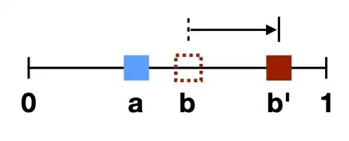

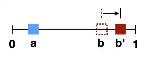

I am trying to find a simple analogous equation describing a repulsion force between two agents. To help with this derivation, I have drawn a physical analogy describing the qualitative interaction between two objects that I am seeking. Consider a fixed object (the blue block) at position $a$ and a movable red block initially at position $b$.
The repulsion equation should capture the qualitative behavior depicted in the following two figures.
In particular, in the first figure, note that when the two blocks are close together, the red block which is pushed to $b'$, far from its initial position $b$. In the second figure, when the two blocks are initially far apart, the red block only moves slightly, from $b$ to $b'$. Note that the updated position of the red block needs to remain within the bounded interval (i.e., less than $1$).
