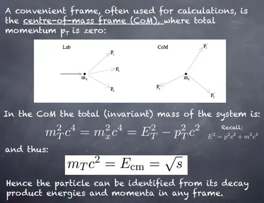

But, in the centre-of-mass frame $p_T=0$, as shown in this image* below:
COM
So therefore,
$$p_T=\sqrt{E_1^2-m_1^2c^4}=0$$ and as a result, $$E_1=m_1c^2$$
My question is, why is the author using the centre-of-mass definition (which I thought required zero total momentum) when the total momentum is actually non-zero (only one particle is stationary)?
*Image in body is from ICL dept. of Physics
The author explicitly states
We will do the calculation in a so-called fixed-target configuration.
So the calculation is done in what is usually called the laboratory frame, and calls it fixed-target in order to emphasize that the target is at rest in this frame.
Because of Lorenz transofrmations, any inertial frame can be used as long as energy and momentum are conserved in the given frame.
The center of mass is used only in order to define s
where s is the square of the centre-of-mass energy.
The calculation is in the lab. s is the "length" of the sum of the four vectors describing the particles involved, for any inertial frame, this is invariant for all inertial frames.
