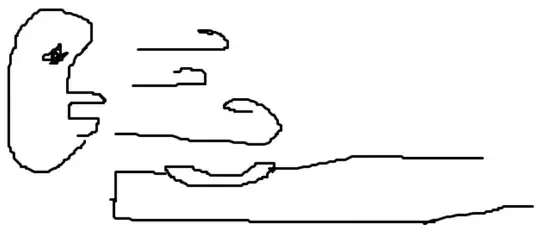

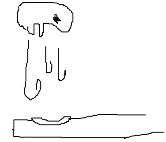

If you were to play a flute, you would want to blow sideways across it, kind of like a bottle, like in Fig 1. Why would this be better than blowing straight in to the hole, like in Fig 2? It seems like more air would go into the flute, which seems like a good thing, so why is it that you blow sideways?
Blowing into a flute sideways, the correct way.
Blowigng straight into a flute, the incorrect way.

To create sound, you would first need to create some kind of a wave, some kind of an oscillation. In the case of a flute, an oscillating column of air works very well, because the flute (its body) resonates at particular frequencies of oscillation and thus you can hear a sound.
What happens when you blow sideways?
Now to create a wave, we need to setup an oscillating jet of air. This is what exactly happens when we blow sideways into the flute. Why? Here's how:
flute
Image source
As you can see in the above image, when we blow a jet of air sideways, the blown air "collides" with the surface of the flute on the other side. You might expect that the air jet would get divided into two parts after striking the surface of the hole, but that's not what really happens$^{\phi}$. Instead, the jet of air rapidly fluctuates between going all into the hole and going all away from the hole. This sets up a rapid vibration at the end of the flute. Once this oscillating air column is set up, the flute's body does the job of amplifying the sound by resonating with this oscillating air column at particular frequencies.

If you blow straight into the hole, you will not be able to setup any kind of air oscillations, except the fluctuations of your blown air. In this scenario, the blown air would simply enter from one end of the flute and exit from the other, producing nothing but some noise (due to the fluctuations of the air you blowed).
