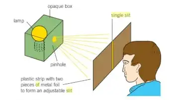

This is a diagram showing the single slit interference set up:
The pinhole (or 'peep hole') is said to 'produce a parallel beam of coherent light, because the time interval between light passing through the pinhole and single slit is constant, producing a constant phase difference'.
However, how would this create coherent light, because the filament lamp is an incoherent source, meaning it emits light at random, so wouldn't rays emerging from the peep-hole also emerge at random?
Also is the peephole even necessary? Because the slit by itself would be narrow enough to create coherent light?

Just as it a choppy (incoherent) sea there are clear wavecrests the light emmited from the incandescent lamp has locally clear wavecrests (although on a much shorter scale). We say that the incoherent light has short range coherence. The pinhole samples only a small part of the wavefront from the light emitted from the lamp, and as long as the pinhole, is smaller than the short coherence length of the light the wavefronts that spread out from the hole will be spatially coherent and good for demonstraing interference due to different path lengths like Young's slits when both slits are at same distance from the pinole. The light from a pinhole will not have good temporal coherence because the period of waves beating on the pinhole will not be strictly periodic so neither will the light emitted from the pinhole. A Mach-Zender interferometer that interferes light against a time delayed verion of itself will not work well therefore.

The slit does not make the light beam coherent. The beam's coherence is primarily a function of the source. You are right that light from a filament is incoherent. It is temporally incoherent (multi-wavelength) and spatially incoherent (spread out in space). A slit does increase the spatial coherence of the light: if you consider the slit to be a source, it can be much smaller than the filament. Interference is possible using light that is only spatially coherent, but if you want easily observed interference fringes, you need light that is both spatially and temporally coherent- like a laser.

Is the peephole even necessary? Because the slit by itself would be narrow enough to create coherent light?
To see interference effects reliably, the phase of the light should be in step everywhere across the hole. In other words, the spatial coherence length should be larger than than the width of the hole.
In general, passing light through a small hole and then letting it expand back out increases the spatial coherence length. To see why, note that for an infinitely small hole, the phase of the light is automatically the same everywhere across the hole (since it's just one point), so it automatically puts out coherent light. So if you use finite-sized holes, you increase the coherence. In fact, in principle you can repeat it, with multiple layers of pinholes, with the light getting more coherent every time. It's just not very useful in practice because this also makes the final light very dim.
The diagram is showing a situation where the slit's size and the lamp's coherence length are so that you need one layer of pinholes in between to reliably see interference effects. But this depends on the parameters. In other situations you could need zero, or two.
