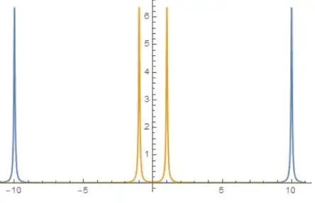

For example, the following plot shows two normalised Lorentzians with the same linewidth, but with a factor of $10$ in FSR. The blue curve looks "better" doesn't it? enter image description here
Finess is a relative measure to how good a cavity is, combining the information of the resonator (FSR) and the materials' quality (linewidth). Physically, you can say: how many times does the linewidth fit in my FSR? That would give you a sense of resolution.
