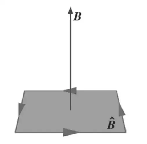

One fact that might help you is the magnetic field isn’t an ordinary vector field... it’s an axial vector field or a psuedovector field. You can’t take the sum of the electric field and a magnetic field.... note that the velocity is an ordinary vector but the cross product of a vector with a psuedovector gives a vector.
Rather than axial vectors or psuedovector, it might be helpful to think of bivectors (for now, oriented parallelograms.... which underlie the cross product). Focus on the parallelogram formed by $d\vec l$ and $\hat r$.
