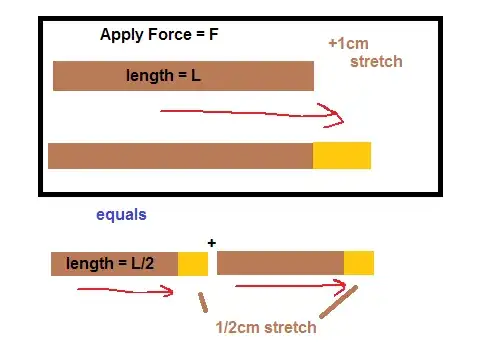

This happens because spring constant is not really a constant. If you consider any normal elastic material, when a force F is applied, the strech is given by hooke's law :
$$\frac{{F}/{A}}{{\Delta L}/{L}}=Y$$
where $Y$ is the young's modulus of material, which is upto a limit, constant and depend only on the material.
This means the strech
$$\Delta L = \frac{FL}{AY}$$
or
$$F = \frac{AY}{L}\Delta L$$
we see that the proportionality constant for spring is thus $\frac{AY}{L}$. Thus, for a spring of $\frac{1}{2}$ the length, spring constant would be double.
For a given deformation, the distance change between two adjacent particles (molecules/atoms) is more if you decrease the length of the spring. Thus, if you keep the displacement small enough so as the intermolecular force is linearly proportional to the intermolecular distance, the force required to produce the same deformation in a short spring is more compared to a longer spring. If you cut a spring into $n$ pieces, the distance change between two particles would have to be $n$ times more to keep the total deformation the same, and linearity tells us that the force required will be $n$ times greater.
Note that the above model may fail as in a real metal spring, there are grain boundaries, dislocations, etc. But it is presents a good intutive picture.
