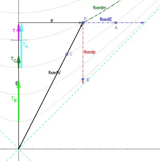

Consider the energy-momentum diagram showing the 4-momentum of a particle with nonzero mass.
The pink arrow represents the relativistic kinetic energy $T$,
which is the relativistic energy $E$ (the tip of the temporal leg)
minus
the rest-energy $mc^2$ (the intersection of the mass-shell with the temporal leg).
  • With fixed $E$, taking the limit of decreasing $m$ increases $T$. With zero $m$, you get $T\rightarrow E_{initial}$.
  • With fixed $p$, taking the limit of decreasing $m$ increases $T$. With zero $m$, you get $T\rightarrow p_{initial}c$.
  • With fixed $v$, taking the limit of decreasing $m$ decreases $T$. With zero $m$, you get $T\rightarrow 0$.
