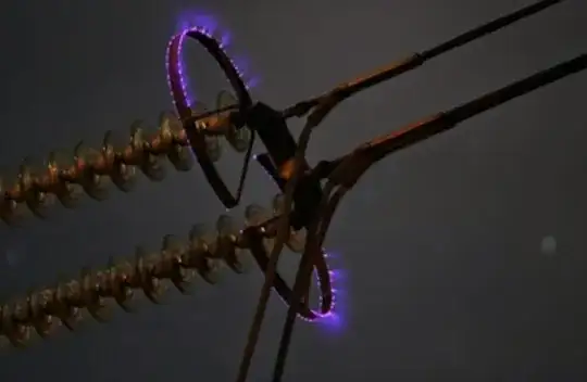

What you heared could well have been the result of corona discharge. Corona discharge is the result of the air surrounding a charged object becoming ionised because the local electric field is very high but not high enough to cause total breaks down of the air. It is often of accompanied by a buzzing and a violet glow which can be seen if it dark.
enter image description here.
The static electricity produced by your son could well have produced an electric field around the twig when it was close to the earthed conductor (trampoline time) to cause the air around the twig to ionisé particularly as a pointed object will enhance the electric field strength.
If is possible to repeat the effect in the dark you might be able see the air glowing as the result of the corona discharge?
