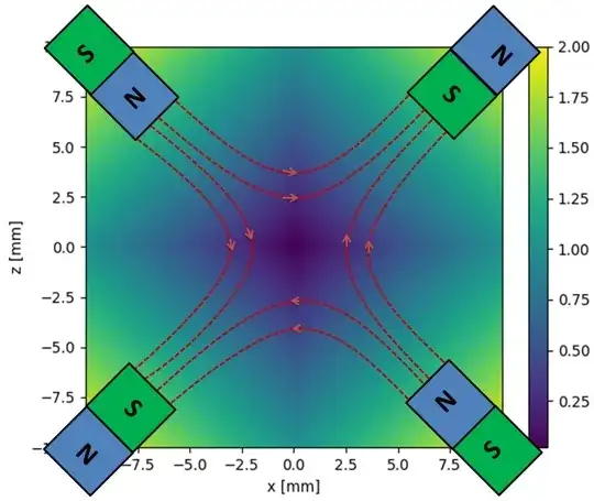

while a set of four magnets with alternating sides facing the inside is described in terms of the quadrupole term. enter image description here

  1. The sketch of the quadrupole does not show the full picture You have to see it in three dimensions. The magnetic field is almost everywhere. It is weakest in a sphere that passes through the center of the magnets.
  2. As in the case of two magnets, the field is of course also formed by the outward pointing parts of the bar magnets. Again three-dimensional.
  3. The only three-dimensional and symmetrical arrangement of magnets with alternating sides facing the inside is this of 8 bar magnets in the edges of a cube. Take this as an axiom.

This is impossible to make on the basis of point 3 of my reply. You can arrange the magnets as in the patterns of a football, but the result is a pattern that is not completely symmetrical as in the following picture $^1$$^)$.

$^1$$^)$ The axiom can be tested by combining every bar magnet that has a closest neighboring magnet of the same orientation into one magnet. If you take more than 8 magnets in any arrangement around the center, you will end up with a maximum of 8 magnets at the corner of a cube.
