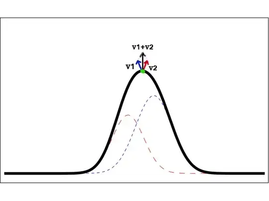

Wave superposition happens because each point in a string of superimposed state, gets a pair of velocities, from a first and second impulse : enter image description here
Actually, it's this individual point speed addition rule that makes wave interference work.
