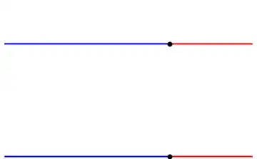

I suppose that if you really insisted on assigning a speed at that moment, you could use the fact that imposing a boundary condition is formally like taking the initial wave, and superposing it with a reflected, upside-down wave that travels "out of the wall". This is illustrated on top below:
Thus, the string wave is always a superposition of a part that travels with uniform velocity to the right, and to the left. So if you wanted to think about a photon this way, then during the reflection, it's in a quantum superposition of going in and out, with all elements of the superposition having speed $c$. But perhaps at this point it's better to step away from the idea of speed here: it's only making things more confusing, and an idea that does that isn't worth keeping!
